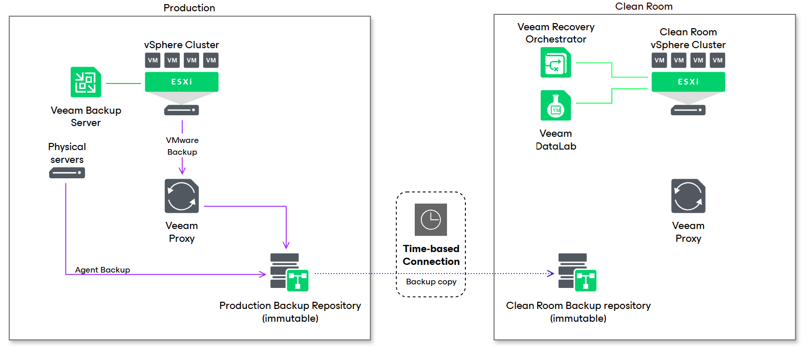

Veeam Clean Room is designed to be a safe place to store and test backups, and a trusted source for clean recovery of workloads while having infected and compromised production environments.
The following is the reference architecture:
reference
Between the Clean Room and the production environment is the network equipment, which controls the isolation and allows limited time connection to transfer backup copies to the Clean Room.

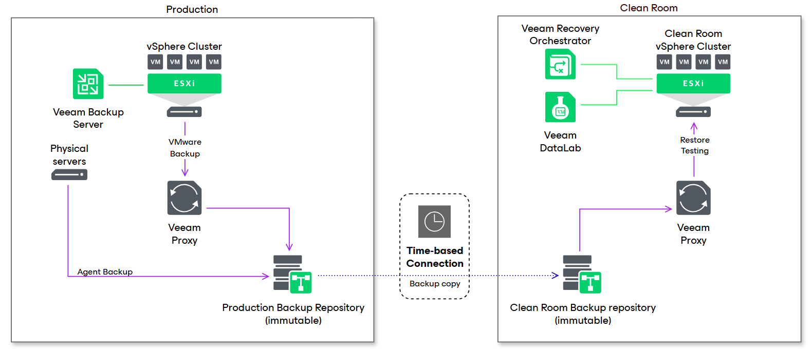

Open Connection Phase
During the open connection phase, the backup repository in the clean room is attached and accessed by the production Veeam Backup & Replication (VBR) server.
open-connection

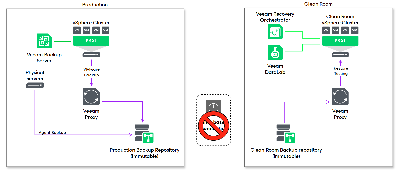

Close Connection Phase
Once the connection is closed down and the production VBR no longer has access to the repository, the embedded VBR inside the Orchestrator connects to the repository, imports the backups and then restore/testing activities may take place.
close-connection
Before the connection is opened again to sync the latest backup copies, the clean room repository is disconnected from the embedded VBR server so the production VBR can safely access data again.

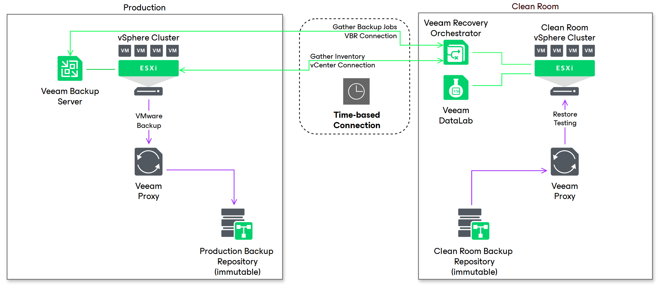

  • The current release of Veeam Recovery Orchestrator (v 13.0.1) requires at minimum an initial connection to the production vCenter to gather inventory and create restore plans using vSphere tags.
    Connection to the production VBR is optional and only required to create restore plans based on backup jobs. gather-inventory

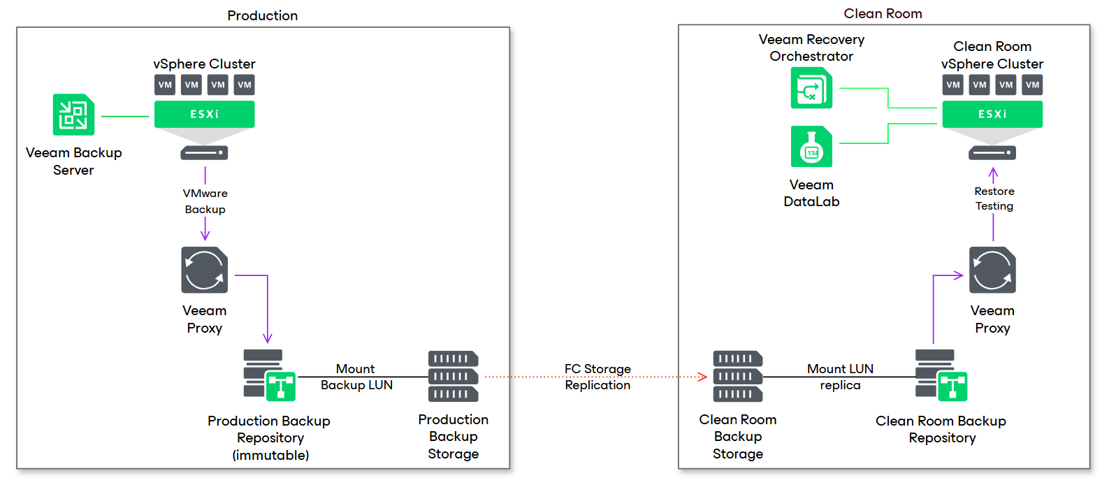

External Storage FC Snapshot/Storage replication
Deviating from the reference design, this scenario is for repositories backed by external storage systems, using storage snapshots or storage replication. It provides stronger isolation leveraging a copy of backup data using fiber channel connections instead of network.
fc-connection
This case assumes the production backup repository is a Veeam Hardened Repository with immutability, so a dedicated Linux server in the clean room has been installed to mount the backup LUN/snapshot from the external storage.
Additional commands are required to present the LUN/snapshot to the Linux server in the clean room, and to mount the LUN/snapshot to the backup mount point in the Linux server.
The rest of the procedure is the same as the Veeam Hardened Repository.
This scenario doesn’t require any special care as there is no risk of concurrency between production and embedded VBR.

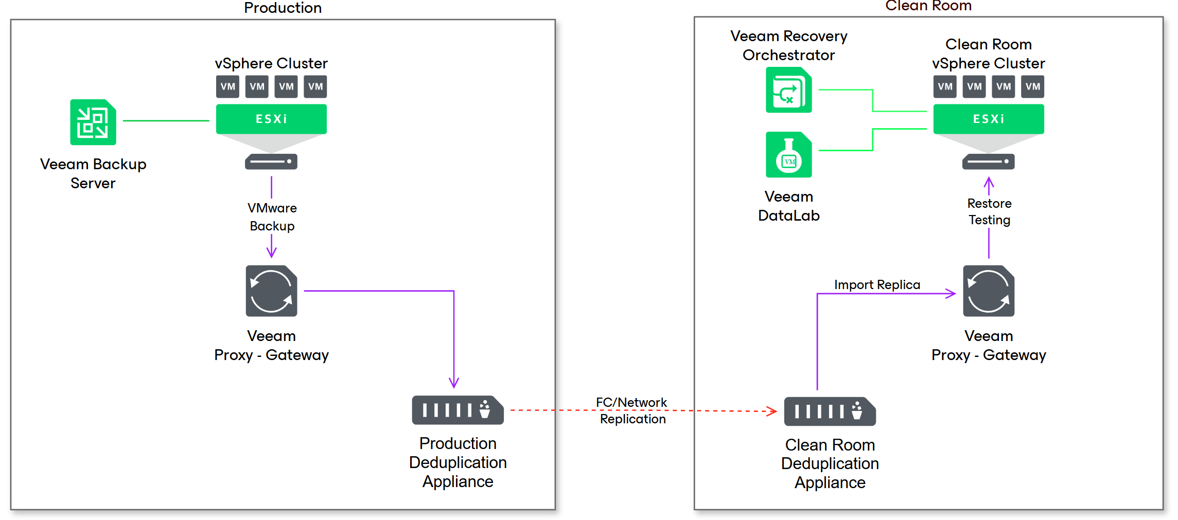

Deduplication Appliance and other systems replication
Other systems, including deduplication appliances, have their own data replication which may be based either on FC or network connection.
Depending on the system, it may be just enough to rescan the contents of the replica, or to detach and reattach the repository.
dedup
