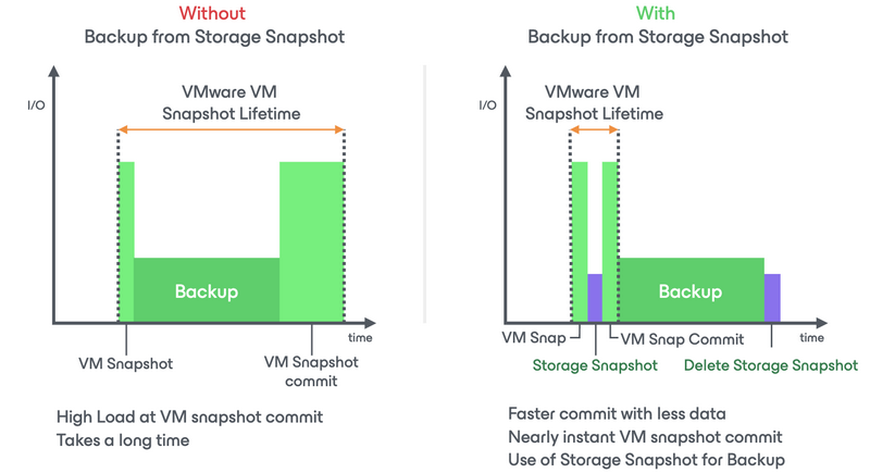

Using backup from storage snapshot significantly reduces the time the vSphere snapshot needs to exist, as shown in the following picture:
Snapshot time comparison
Backup from storage snapshot is not always recommended, as it increases the number of tasks that a backup job must go through before it starts processing data: A vSphere snapshot of all the VMs that are part of the job must be taken before creating the actual hardware snapshot.

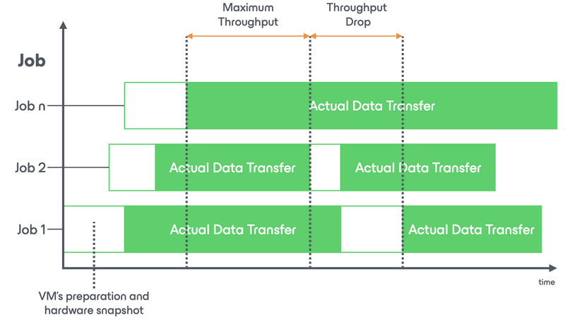

Scheduling also plays a crucial role when it comes to this backup mode: As mentioned above, since all the VM’s have to be quiesced before creating the hardware snapshot, to guarantee a sustained throughput multiple backup jobs must run in parallel.
Job schedule

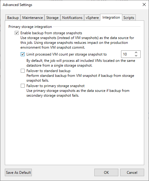

As it is shown in the picture above, jobs should start within an interval of 5 minutes one to the next and, in the advanced options, the option to limit the number of VMs to be processed within a single hardware snapshot should be set to 10 or less (depending on how many concurrent jobs will run).
Job options
Limiting the number of VMs within an hardware snapshot is key to reduce the time in which the vSphere snapshot is open to a minimum, thus reducing the impact on the VMs. Without this option enabled, the job will quiesce first all the VMs before creating the hardware snapshot and, if the job has to process an high number of VMs, the vSphere snapshot of the first ones processed may grow considerably.

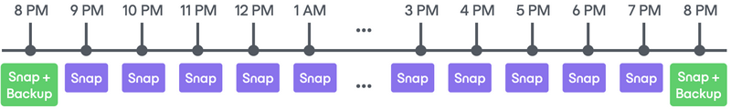

Using snapshot-only jobs is like scheduling automatic snapshots creation in the storage management console: The job produces a snapshot that is stored within the same storage array and controls frequency and retention of that chain of restore points. No additional backup file will be saved in the backup repository: The snapshot chain is self-consistent and provides the same recovery capabilities as if it was a regular backp file.
Depending on the backup job settings, the created snapshots can be application-consistent or crash-consistent. If application-aware image processing is enabled, during the job session, Veeam Backup & Replication will interact with the guest OS creating a vSphere snapshot and proceeds as it does for normal backup jobs. Right after this step, the hardware snapshot is created.
Regardless of the consistency of the snapshot, we do recommend to include snapshot-only jobs as part of your data protection strategy, especially for the most critical VMs hosted in your virtual infrastructure. The overhead generated by this type of job is very small compared to the standard backup process, and modern storage systems make use of smart ways to store these snapshosts efficiently, reducing the space needed to store them to the bare minimum.
Also, applications like Microsoft SQL and Exchange can use these Snapshot only jobs to create a snapshot chain for fast recovery and increase the protection level by generating restore points at a very low cost in terms of impact and consumed space, even outside the usual nightly backup window.
